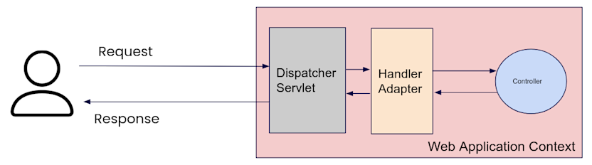

Sounds like a lot of tedious work. Luckily, Spring already does that for us by providing a single servlet called the Dispatcher Servlet!
Dispatcher Servlet
SpringMVC
Imagine you have a Spring Application with some defined Controllers that provide request mappings (e.g. methods annotated with @RequestMapping). In this case, whenever a http request reaches our application the Dispatcher Servlet will invoke specific handlers that
  • look at the request URI, extract request parameters, and route to the corresponding controller method
  • automatically convert the request body into the Java DTO specified in your controller method
  • serialize whatever your controller method returns into a transport-friendly format such as JSON and hand it over to the servlet container
For all of this to happen, Spring provides a bunch of HandlerAdapters. In the context of asynchronous request processing, we'll have a look specifically at ReturnValueHandlers which - you guessed it - are selected based on what kind of object you return from your controller method.

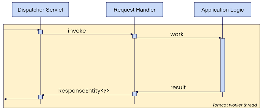

Synchronous Request Processing
When doing synchronous processing, we only return from our request handler (i.e. your controller method annotated with @RequestMapping) after the application has done its work, blocking the servlet worker thread in the process.
SynchronousRequest
In this mode, the amount of work our application can do in parallel is limited by the tomcat worker thread pool size.
Now, if our application logic processes some I/O heavy workload or delegates work to another thread pool (for resource management or other reasons) our servlet thread is effectively just sitting idle but still consuming resources instead of working on the next request.
Wouldn't it be nice if there was a way to use our threads more efficiently?

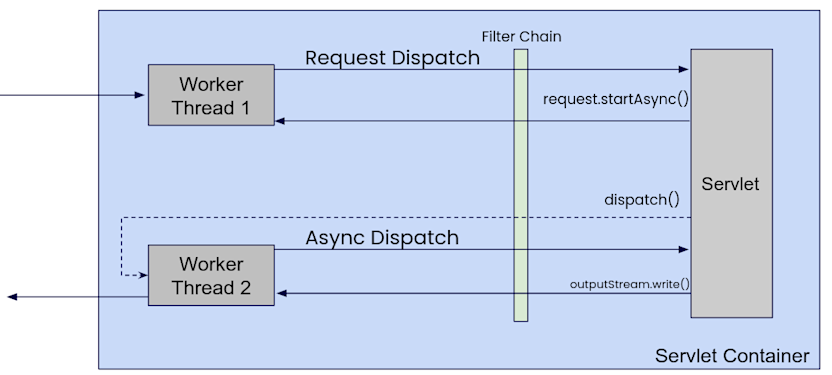

Now what does "putting a request into async mode" actually mean?
AsyncDispatch
When returning a DeferredResult from a controller method, the corresponding ReturnValueHandler calls startAsync() on the http request before returning it. This signals the Servlet Container to release the worker thread but to keep this request open as the processing is not done yet.
All of this happens inside the initial servlet dispatch (REQUEST) as shown in this pseudo code
    public void handle(DeferredResult deferredResult, HttpServletRequest request) {
    var asyncContext = request.startAsync();
    deferredResult.setCompletionCallback(result -> {
        AsyncManager.setResultForRequest(asyncContext, result);
        asyncContext.dispatch();
At some later point, when the actual result is passed to the DeferredResult we invoke the completion callback which triggers a second dispatch (ASYNC).
    public void setResult(Object result) {
    completionCallback.accept(result);
The async dispatch just retrieves whatever was stored by the completion callback and returns it to the caller in the same way as a regular synchronous request would. From the caller's perspective, both synchronous and the asynchronous workflow are the same.
    protected void doGet(HttpServletRequest httpRequest, HttpServletResponse httpResponse) {
    if (httpRequest.getDispatcherType() == DispatcherType.ASYNC) {
        var asyncResult = AsyncManager.getResultForRequest(httpRequest);
        httpResponse.getOutputStream().write(asyncResult);
        return;
One thing to consider is that your request passes the filter chain twice (once for each dispatch) in case you do any fancy custom processing.

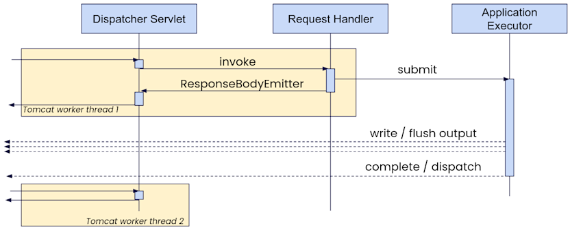

Streaming Data
Not having to wait for the full response to be complete also provides another benefit - we can even send intermediate results when they are ready by streaming data!
This can be achieved in multiple ways, one of them being using the ResponseBodyEmitter. There are specialized subclasses of it like the SseEmitter that can be used for streaming mechanisms like server-sent events (SSE).
ServerSentEvents
Similar to the DeferredResult, the request handler returns immediately after creating the ResopnseBodyEmitter and frees up the servlet worker thread. Only this time the application logic can publish multiple results which can be immediately flushed to the client without closing the connection. This is usually wrapped in the SSE format mentioned above or simply using newline delimited json objects.
The pseudo-code for our ReturnValueHandler in spring would look like this
    public void handle(SseEmitter emitter, HttpServletRequest request,
                   HttpServletResponse response) {
    response.setContentType("text/event-stream"); // server sent events format
    emitter.initialize(asyncContext);
We set the content-type of the response to a streaming format - in this example SSE - and put the request into async mode.
The emitter itself would provide the following two (oversimplified) methods:
    public void send(String value) {
    var payload = "data: " + value + "\n\n"; // SSE format
    asyncContext.getResponse().getOutputStream().write(payload.getBytes());
    asyncContext.getResponse().flushBuffer();
public void complete() {
Every time the application code wants to send an object it is converted to the streaming format (here SSE) and flushed to the response output stream. Once the request is completed, an ASYNC dispatch is triggered, cleaning up the request.
Another way to stream data would be making use of the reactive type Flux which internally works slightly differently than our ResponseBodyEmitter but will produce the same result.
