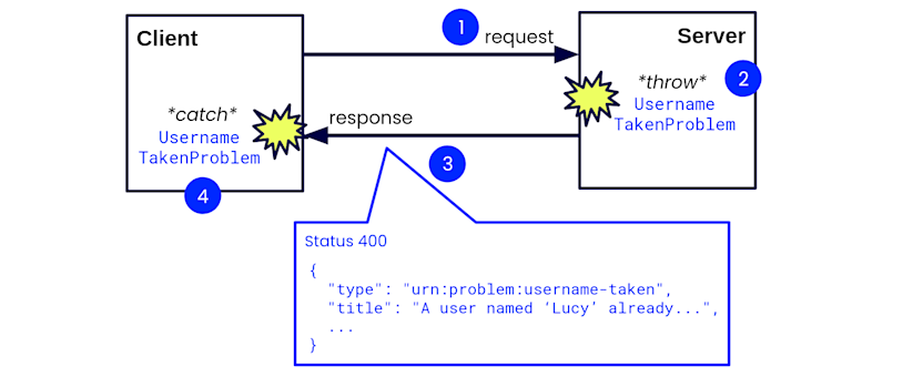

Problem JSON example
  1. The client sends a request to the server.
  2. The server tries to answer the request but runs into a problem, so a Problem Exception is thrown:
        // Throw the Problem like any ordinary Exception
    throw new UsernameTakenProblem(providedUsername);
  3. The Exception is turned into its corresponding Problem JSON representation. The Problem library does this for us. We only have to provide mappings between Problem types and their respective Exceptions. The properly serialized JSON response is then returned to the client.
  4. The client receives the Problem JSON response which is then translated into the original Exception by the client library. This exception can now be caught, just like any other Exception:
        try {
        apiClient.createUser("Lucy");
        // The API client automatically turns Problem JSON responses into exceptions
    } catch (MalformedInputProblem e) {
        // Here, we can deal with the case that the input is malformed
    } catch (UserNameTakenProblem e) {
        // And here, we can deal with the case that the username is taken
There you have it. With Problem JSON (or rather, the tooling around it) we can transmit errors in a well-defined and type-safe fashion across the network.
